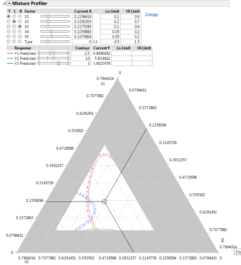

Select Graph > Mixture Profiler.
Select Y1 Predicted, Y2 Predicted, and Y3 Predicted and click Y, Predicted.
5.
Enter 3 in the Contour edit box for Y3 Predicted so that the contour is visible on the plot.
Figure 5.11 Mixture Profiler with Y3 Predicted Contour Set to 3
The on axis factors are X1, X2, and X3 as indicated by the axes labels and the radio buttons in the factor settings. All of the factors have low and high limits, which were entered previously as Column Properties. See Column Properties in the Using JMP book for more information about entering column properties. Alternatively, you can enter the low and high limits directly by entering them in the Lo Limit and Hi Limit boxes.

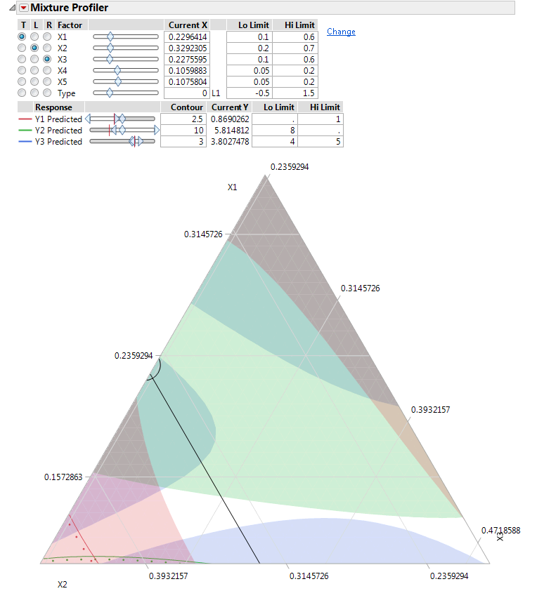

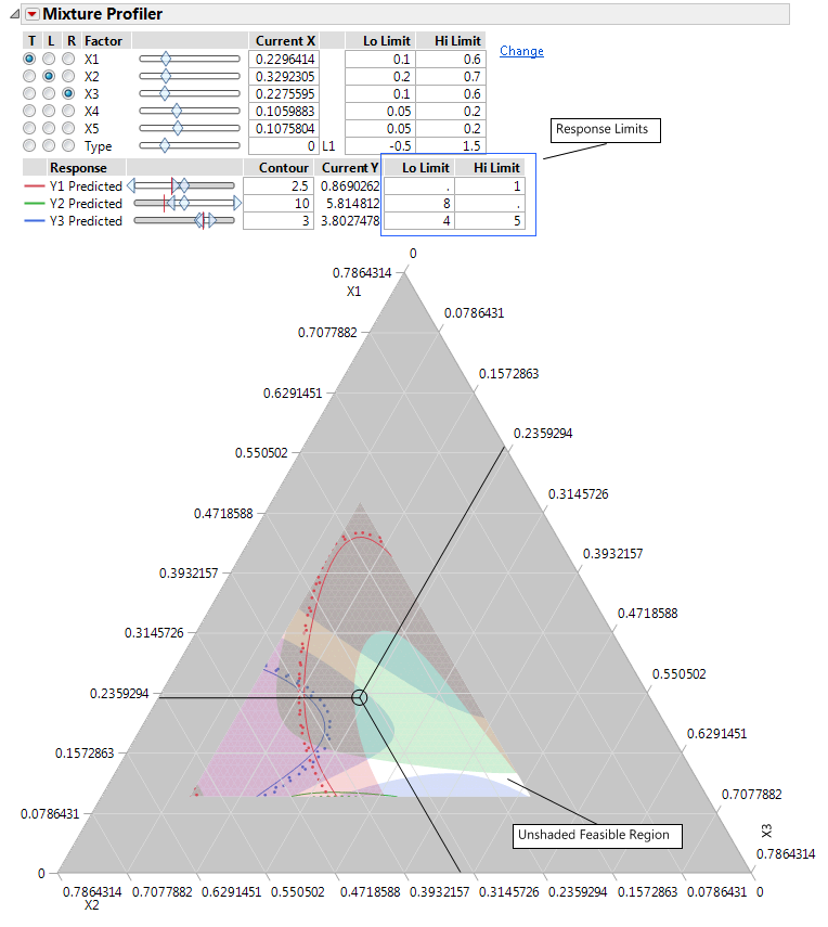

Suppose the manufacturer desires to hold Y1 less than 1, Y2 greater than 8 and Y3 between 4 and 5, with a target of 4.5. The Mixture Profiler can help you investigate the response surface and find optimal factor settings.
Figure 5.12 Feasible Region After Setting Response Limits
Figure 5.13 Ternary Plot with Enlarged Feasible Region

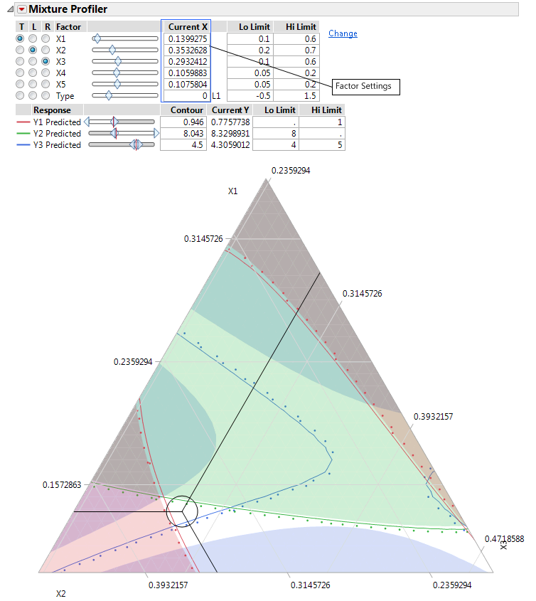

Enter 4.5 in the Contour edit box for Y3 Predicted to set the blue contour to the target value.
The resulting three contours do not all intersect at one spot. Y1 and Y2 cannot be optimized with Y3 on target, so you have to compromise. Position the three-way crosshairs in the middle of the contours to explore the factor levels that produce those response values. Note that these response contours are for the current settings of x4, x5, and Type.
Figure 5.14 Factor Settings for Optimal Results
