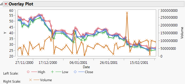

A second y-axis is useful for plotting data with different scales on the same plot, such as a stock’s closing price and its daily volume, or temperature and pressure. For example, consider plotting the selling price of an inexpensive stock against the Dow Jones Industrial Average.
5.
6.
Click OK.
7.
From the red triangle menu for Overlay Plot, select Y Options > Connect Points.
Figure 4.9 Dual Axis Overlay Plot
The variables High, Low, and Close are the stock prices of the same stock and thus are on the same scale. Volume is a different scale entirely, representing the trading volume of the entire Dow Jones Industrial Average.

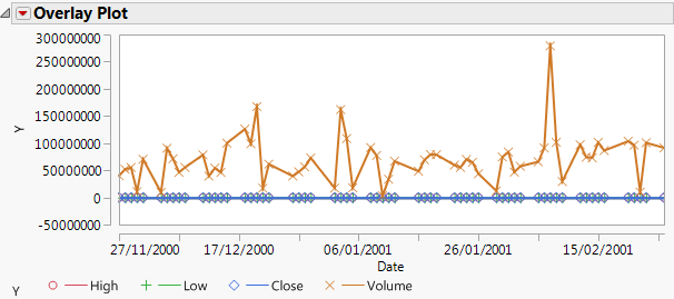

To see why this matters, perform the same steps above without clicking the Left Scale/Right Scale button for Volume. Compare the resulting graph in Figure 4.10 to Figure 4.9.
Figure 4.10 Single Axis Overlay Plot
