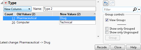

Select the Type column by clicking once on the column heading.
Select Cols > Recode.
In the Recode window, enter the desired values in the New Value boxes. For this example, enter Technical in the Computer row, and Drug in the Pharmaceutical row.
Figure 3.40 Recode Window

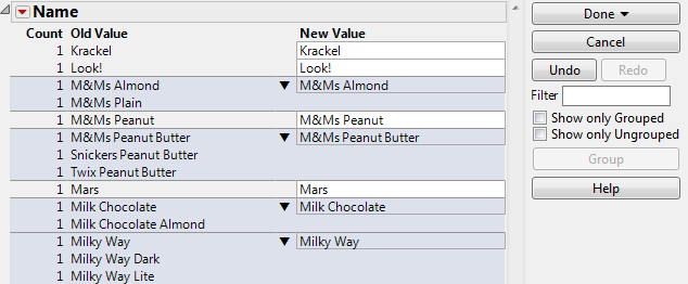

Figure 3.41 Grouped by Character Difference
In this example, the grouped values have no more than 6 characters different between them. The values shown in the New Value column represents the grouped values in the recoded data table.

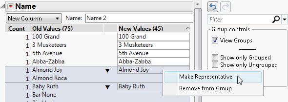

Right-click Almond Roca and select Make Representative to change the new value to represent a different value within the group.
Figure 3.42 Make Representative
To remove values from a group, right-click and select Remove from Group.

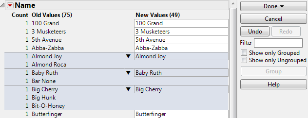

Figure 3.43 Grouped by Difference Ratio

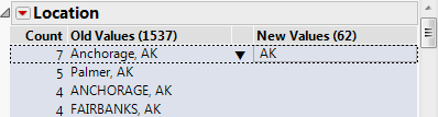

The Aircraft Incidents.jmp sample data table contains a column of city and state names separated by a comma. You can split the values in that column on the comma and recode the column with only state names.
Select Split on from the red triangle menu.
5.
Do not change the default First occurrence setting. In these data, the state is the first occurrence after the comma.
6.
Select Text after to recode the column with only state names.
7.
Do not change the default Keep text if no match setting. You do not want to delete unmatched text.
8.
Click OK.
Figure 3.44 Recoded City, State Name
