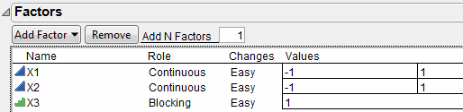

Select DOE > Custom Design.
Type 2 next to Add N Factors.
Click Add Factor > Continuous.
5.
Click Continue.
The Default number of runs is 12. The Factors outline updates to show three levels for the Blocking factor, X3. Because you required X3 to have four runs per block, the 12 runs allow three blocks.

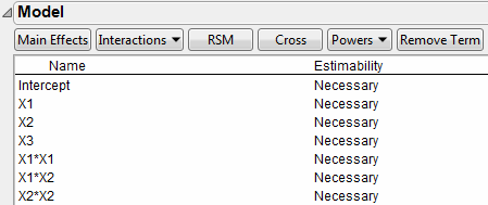

Click RSM.
7.
Click OK to dismiss the message.
Quadratic and interactions terms for X1 and X2 are added to the model. Because you added RSM terms, the Recommended optimality criterion changes from D-Optimal to I-Optimal. You can see this later in the Design Diagnostics outline.
Figure 4.36 Model Outline with Response Surface Effects

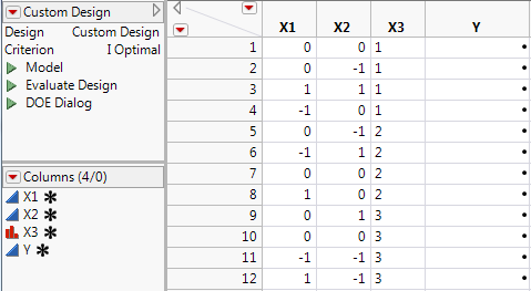

Click Make Table.
Figure 4.38 Design Table with Blocking Factor
Because the default Run Order was Randomize within Blocks, the levels of the blocking factor (X3) are sorted.

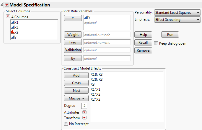

Figure 4.39 Fit Model Window
The blocking factor (X3) is entered as an effect.
No interactions involving X3 are included.
