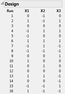

Click Make Design.
Figure 4.26 RSM Design
In order to estimate quadratic effects, a response surface design uses three levels for each factor. Note that the design in Figure 4.26 is a face-centered Central Composite Design with two center points.

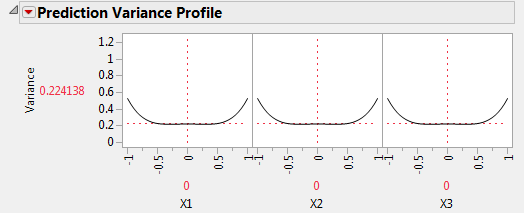

Open the Design Evaluation > Prediction Variance Profile outline.
Figure 4.28 Prediction Variance Profile

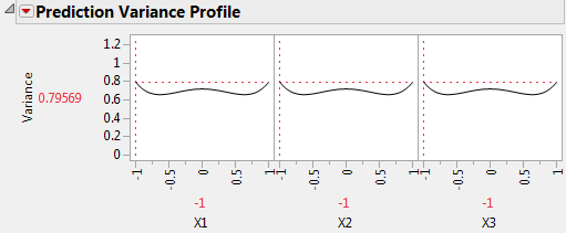

The vertical axis shows the relative prediction variance of the expected value of the response. The relative prediction variance is the prediction variance divided by the error variance. When the relative prediction variance is one, its absolute variance equals the error variance of the regression model.
14.
Select Maximize Variance from the red triangle menu next to Prediction Variance Profile outline.

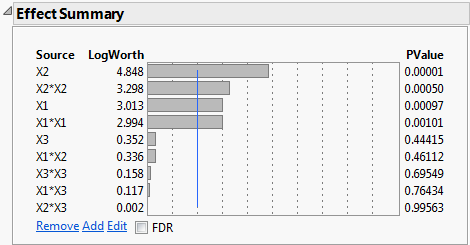

The Custom RSM.jmp sample data table contains the results of the experiment. The Model script opens a Fit Model window showing all of the effects specified in the DOE window’s Model outline. This script was saved to the data table by the Custom Design platform.
In the Table panel, click the green triangle next to the Model script.
Click Run.
Figure 4.31 Effect Summary Report

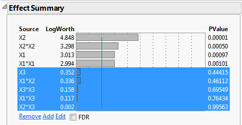

The report shows that X1, X2, X1*X1, and X2*X2 are significant at the 0.01 level. None of the other effects are significant at even the 0.10 level. Reduce the model by removing these insignificant effects.
5.
Click Remove.
The Fit Least Squares report is updated to show a model containing only the significant effects: X1, X2, X1*X1, and X2*X2.

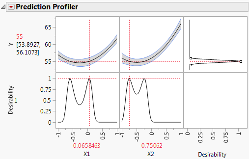

Use the Prediction Profiler (at the bottom of the Fit Least Squares window) to explore how the predicted response (Y) changes as you vary the factors X1 and X2. Note the quadratic behavior of Y across the values of X1 and X2.
Remember that you entered response limits for Y in the Responses outline of the Custom Design window. As a result, the Response Limit column property is attached to the Y column in the design table. The Desirability function for Y (in the top plot at right) is based on the information contained in the Response Limit column property. JMP uses this function to calculate Desirability as a function of the settings of X1 and X2. The traces of the Desirability function appear in the bottom row of plots.
6.
In the Prediction Profiler report, select Optimization and Desirability > Maximize Desirability from the red triangle options.
Figure 4.33 Prediction Profiler with Desirability Maximized
The predicted response achieves the target value of 55 at the process settings shown in red above X1 and X2. Figure 4.33 shows that a value of X1 near –0.65 also achieves a predicted value of 55 when X2 = -0.75062. In fact, your Prediction Profiler might show different settings as those that maximize desirability. This is because the predicted response is 55 for many settings of X1 and X2.

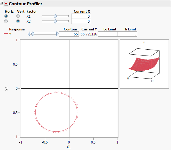

7.
Select Factor Profiling > Contour Profiler from the red triangle next to Response Y.
Figure 4.34 Contour Profiler
The settings of X1 and X2 that correspond to the red contour have predicted response values of 55. You might want to select from among these process settings based on cost efficiency.
