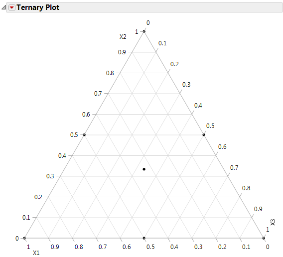

From design table, select Graph>Ternary Plot.
7.
Select X1, X2, and X3 and click X, Plotting, and then click OK.
Figure 12.9 Ternary Plot for Simplex Centroid Design
