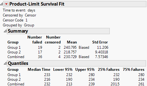

For data that is not interval censored, the initial reports show Summary and Quantiles data (Figure 12.15). The Summary data shows the number of failed and number of censored observations for each group (when there are groups) and for the whole study. The mean and standard deviations are also adjusted for censoring. For computational details about these statistics, see the LIFETEST Procedure chapter in the SAS/STAT 14.3 User’s Guide (2017).
D is the number of distinct event times
t0 is defined to be 0

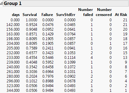

Figure 12.17 shows an example of the product-limit survival function estimates for one group.
Figure 12.17 Example of Survival Estimates Table
Note: When the final time recorded is a censored observation, the report indicates a biased mean estimate. The biased mean estimate is a lower bound for the true mean.
with a standard error of
is the survival distribution at time
