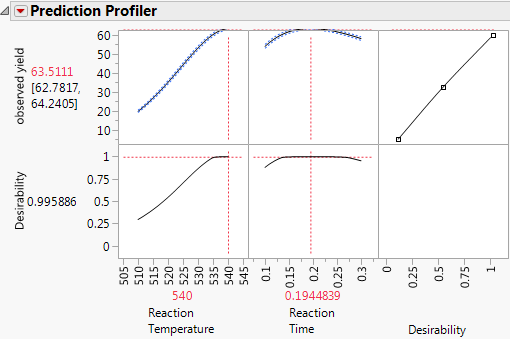

To maximize the yield, click the Prediction Profiler red triangle menu and select Optimization and Desirability > Maximize Desirability.
Figure 23.6 Time and Temperature Settings for Maximum Yield
