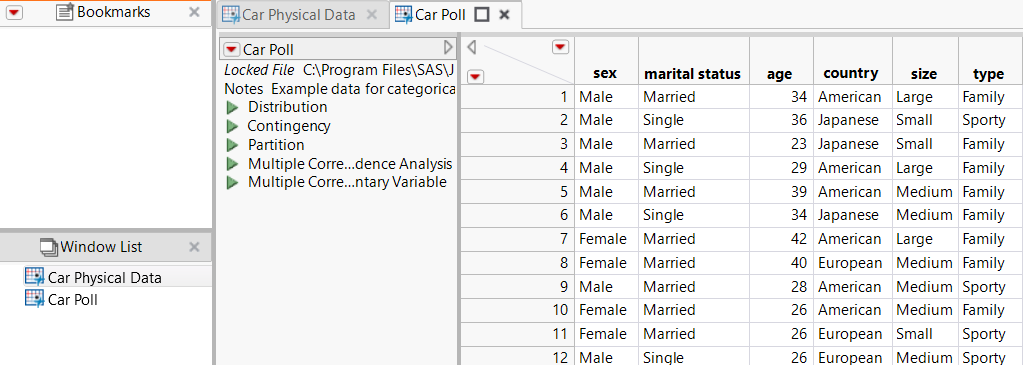

To start a new project, select File > New > Project. A window appears that shows the untitled project.
Click Open.
5.
Figure 10.16 Initial Project

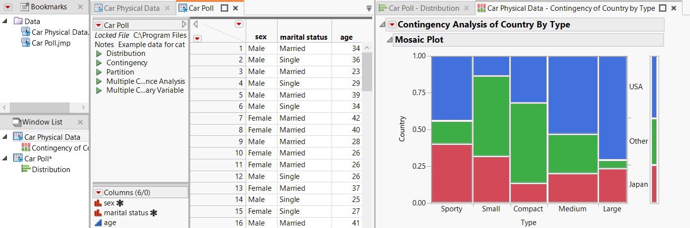

Create a group for the data tables by selecting New Group from the Bookmarks red triangle menu. The group organizes the files but does not move them on your computer.
Figure 10.17 Bookmarked Files
In Car Physical Data.jmp, run the Contingency script.
In Car Poll.jmp, run the Distribution script.
Figure 10.18 Tabbed Reports

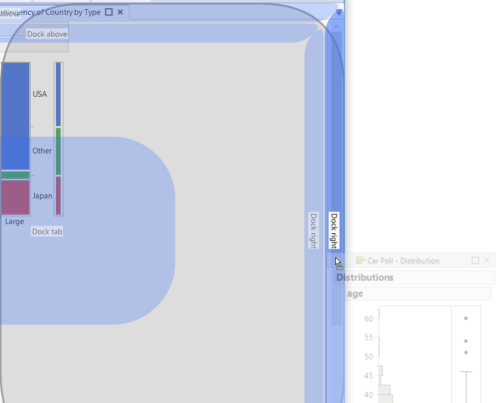

Drag the Distribution report tab to the right until the Dock right zone appears on the far right.
Figure 10.19 Dragging a Report

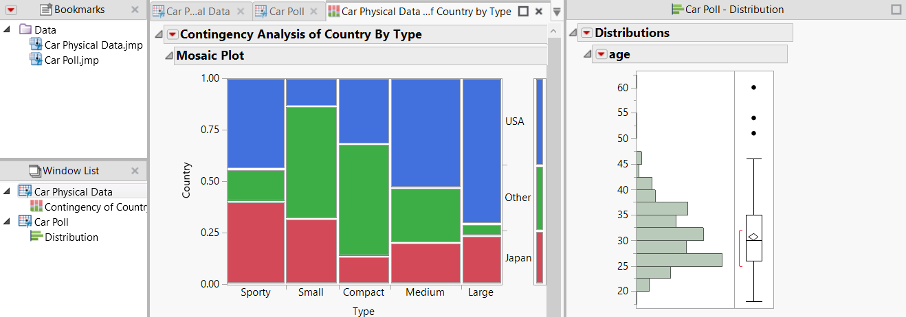

Drop the report into the Dock right zone.
Figure 10.20 Report in New Pane

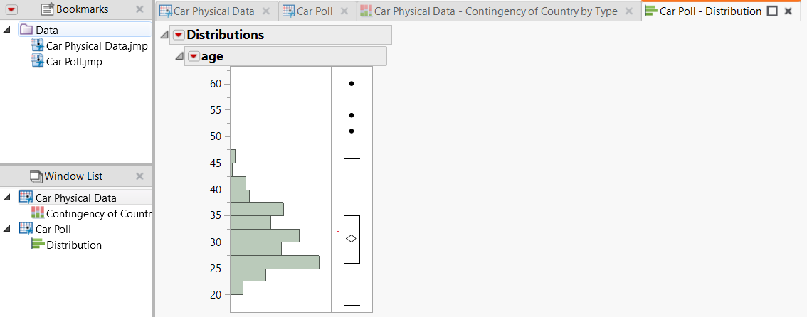

6.
When the Dock tab zone appears, drop the report.
Figure 10.21 Docked Report Tabs
