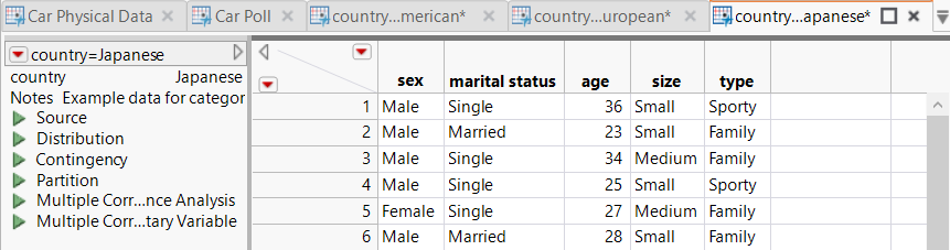

When you modify a file (for example, a data table or script) inside a project, an asterisk appears on the tab to indicate that the file is not saved. Select File > Save and save the file to your computer. Then, select File > Save Project to save the project.
In the project, select the Car Poll.jmp tab.
Select Tables > Subset.
Select Subset by.
5.
Figure 10.22 New Subset Data Tables
6.
Select each new tab, select File > Save, and save the file on your computer.
7.
Select File > Save Project to save the data tables in the project.

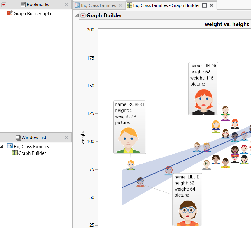

Select File > New > Project to create an empty project.
5.
6.
In JMP, from the Bookmarks red triangle menu, select Add Files, navigate to the Graph Builder.pptx file that you created, and then click Open (Windows) or Choose (Macintosh).
Figure 10.23 Bookmarked PPTX File
