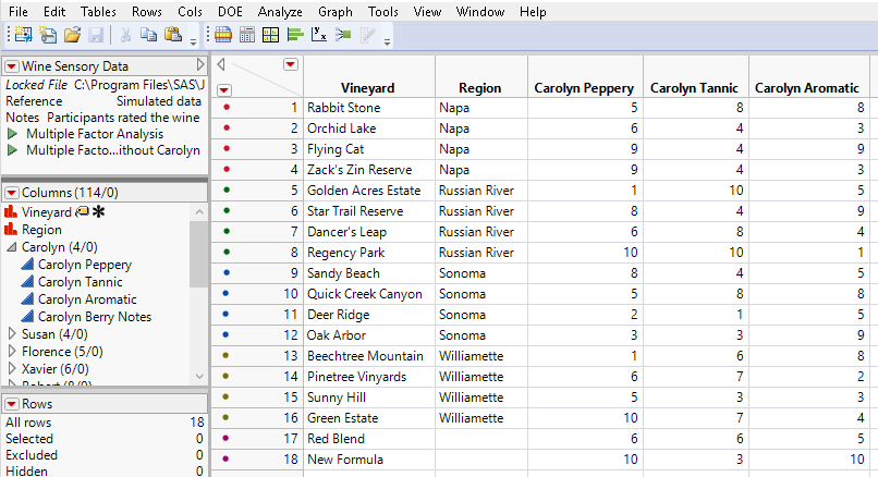

The data table rows represent the items that are being measured. Observations for each item must be in a single row. For example, Figure 7.5 shows a table that is measuring attributes of 16 wines from different vineyards. The column panel shows the column groups, or sub-tables, for each panelist. The Vineyards in rows 17 and 18 are not assigned a Region. The analysis could be used to explore which region the vineyards are most aligned to.
