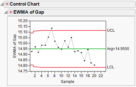

The following example uses the Clips1.jmp data table.
Select Analyze > Quality and Process > Control Chart > EWMA.
5.
Change the Weight to 0.5.
6.
Click OK.
Figure 4.26 EWMA Chart
The EWMA chart appears for the same data shown in Figure 4.25. This EWMA chart was generated for weight = 0.5.
