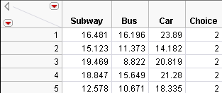

Consider the data from Daganzo, found in Daganzo Trip.jmp. This data set contains the travel time for three transportation alternatives and the preferred transportation alternative for each subject.
Select Help > Sample Data Library and open the Daganzo Trip.jmp data table.
Figure 4.43 Partial Daganzo Trip Table

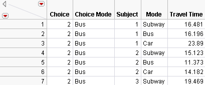

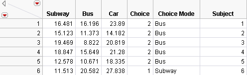

The new Choice Mode column appears in the data table. Because each row contains a choice made by each subject, another column containing a sequence of numbers should be created to identify the subjects.

Figure 4.45 Partial Daganzo Trip Data with New Choice Mode and Subject Columns

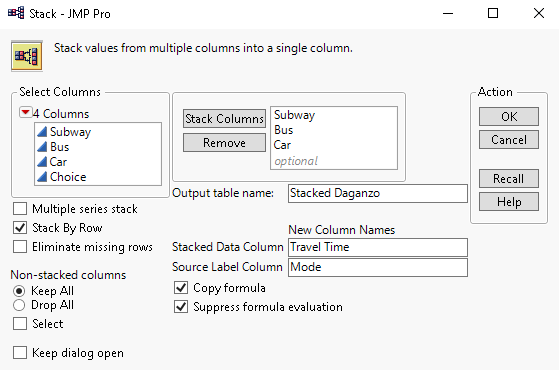

Select Tables > Stack.
Select Subway, Bus, and Car and click Stack Columns.
For the Output table name, type Stacked Daganzo. Type Travel Time for the Stacked Data Column and Mode for the Source Label Column.
Figure 4.46 Stack Dialog for Daganzo Data

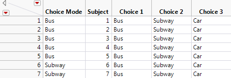

For the Response Data Table, you need the Subject and Choice Mode columns, but you also need a column for each possible choice.
From the Daganzo Trip.jmp data, select the Subject and Choice Mode columns.
Select Tables > Subset.
Select All Rows and Selected Columns and click OK.
Select Cols > New Columns.
Select Data Type>Character.
10.
The columns Choice 1, Choice 2, and Choice 3 have been added.
11.
Type “Bus” (without quotation marks) in the first row of Choice 1. Right-click the cell and select Fill > Fill to end of table.
12.
Type “Subway” (without quotation marks) in the first row of Choice 2. Right-click the cell and select Fill > Fill to end of table.
13.
Type “Car” (without quotation marks) in the first row of Choice 3. Right-click the cell and select Fill > Fill to end of table.
Figure 4.49 Partial Subset Table of Daganzo Data with Choice Set

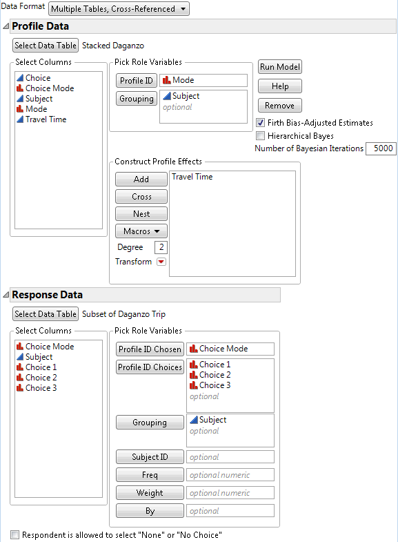

Now that you have separated the original Daganzo Trip.jmp table into two separate tables, you can run the Choice Platform.
Select Analyze > Consumer Research > Choice.
From the Data Format list, select Multiple Tables, Cross-Referenced.
Figure 4.50 Choice Dialog Box for Subset of Daganzo Data

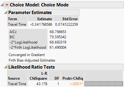

Click Run Model.
Figure 4.51 Parameter Estimate for Travel Time of Daganzo Data
