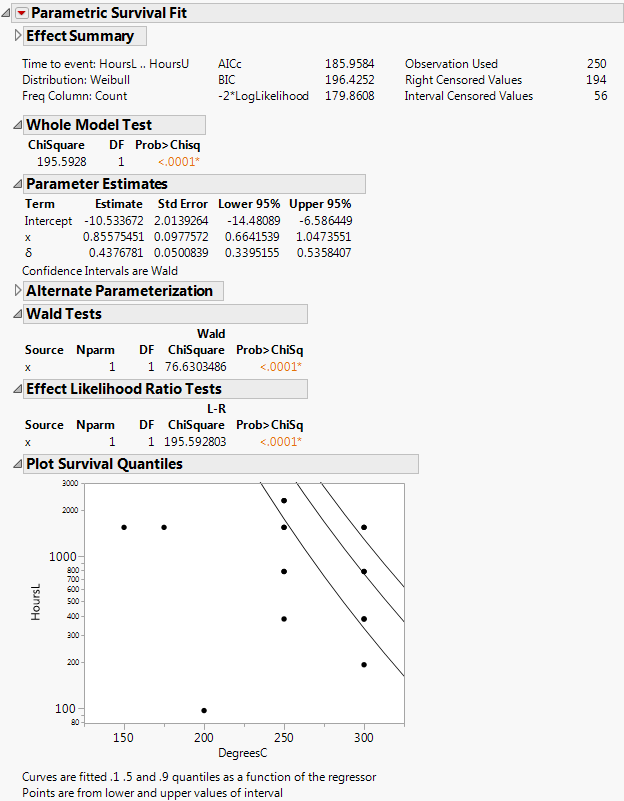

The ICdevice02.jmp data shows failures that were found to have happened between inspection intervals. The model uses two y-variables, containing the upper and lower bounds on the failure times. Right-censored times are shown with missing upper bounds.
Select Analyze > Reliability and Survival > Fit Parametric Survival.
5.
6.
Click Run.
Figure 14.12 ICDevice Output
