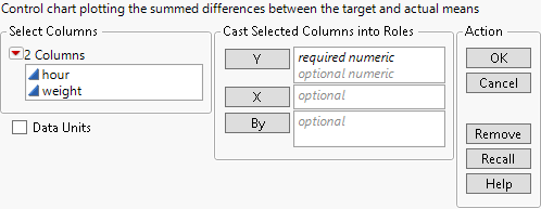

Launch the CUSUM Control Chart platform by selecting Analyze > Quality and Process > CUSUM Control Chart.
Figure 5.3 The CUSUM Control Chart Launch Window
When you use standard deviation units, values for the h and k parameters do not depend on the process standard deviation. This can be an advantage.
