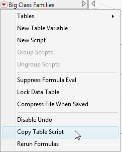

In the data table, select Copy Table Script from the data table red triangle menu.
Figure 10.15 Copying a Table Script
In the journal, right-click and select Add Script Button.
