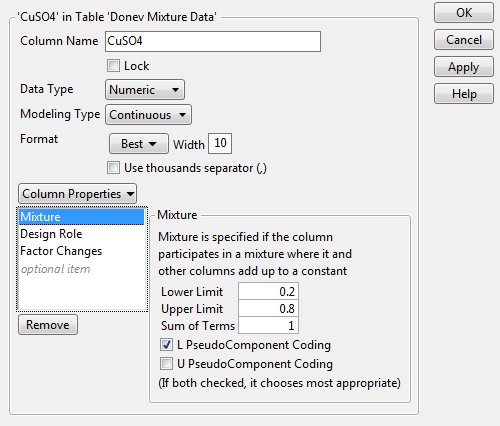

Click the asterisk next to CuSO4 in the columns panel and select Mixture.
Figure A.20 Mixture Column Property Panel for CuSO4
The L PseudoComponent Coding option is selected. See PseudoComponent Coding.

Click the asterisk next to Glyoxal in the columns panel and select Mixture.
5.
Click Cancel.

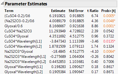

Click Run.
Figure A.21 Parameter Estimates Report

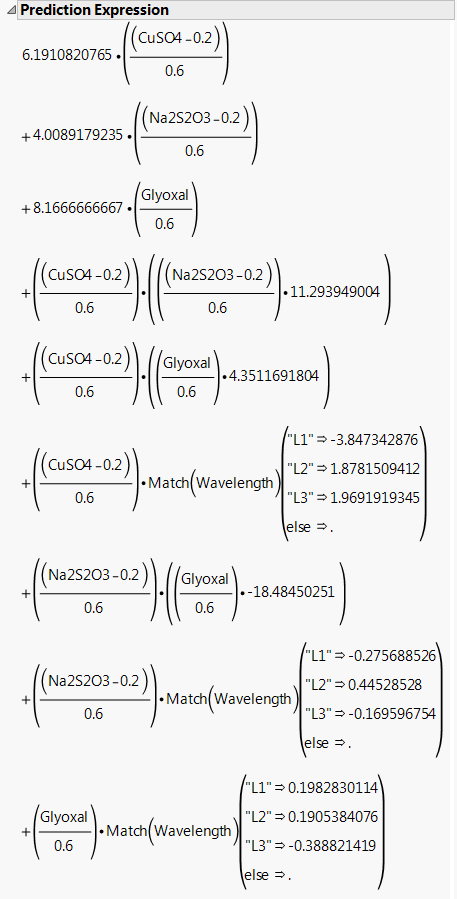

Select Estimates > Show Prediction Expression from the Response Damping red triangle menu.
Figure A.22 Prediction Expression for Damping Model
Suppose that you are interested in predictions at Wavelength L2. Suppose also that Na2S2O3 and Glyoxal are set to their low values, 0.2 and 0 respectively, and that CuSO4 is set to its high value, 0.8. In this case, the predicted Damping equals the parameter estimate for CuSO4 (6.191) plus the parameter estimate for CuSO4*Wavelength[L2] (1.878). You can verify this in the Prediction Profiler.

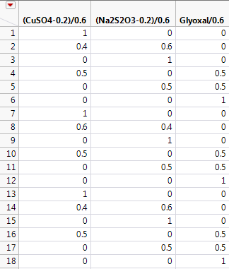

Select Save Columns > Save Coding Table from the Response Damping red triangle menu.
Figure A.23 First Three Columns of Coding Table Showing Coded Mixture Factors
