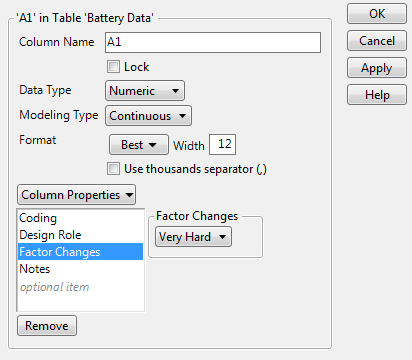

The Factor Changes column property indicates how difficult it is to change factor settings in a designed experiment. The possible specifications for Factor Changes are Easy, Hard, and Very Hard. For example, Figure A.24 shows the Factor Changes column property panel for the factor A1 in the Battery Data.jmp sample data table, located in the Design Experiment folder.
Figure A.24 Factor Changes Column Property Panel
