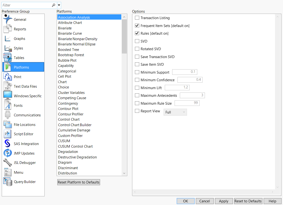

To prevent an option from appearing in the report, next to an option, select Set but do not select the option.
To ensure an option appears in the report, select Set and select the option.
Click Reset Platform to Defaults to return the selected platform options to the default settings.
Click Reset to Defaults to return all platforms to their default settings.
Figure 13.6 Platforms Preferences
