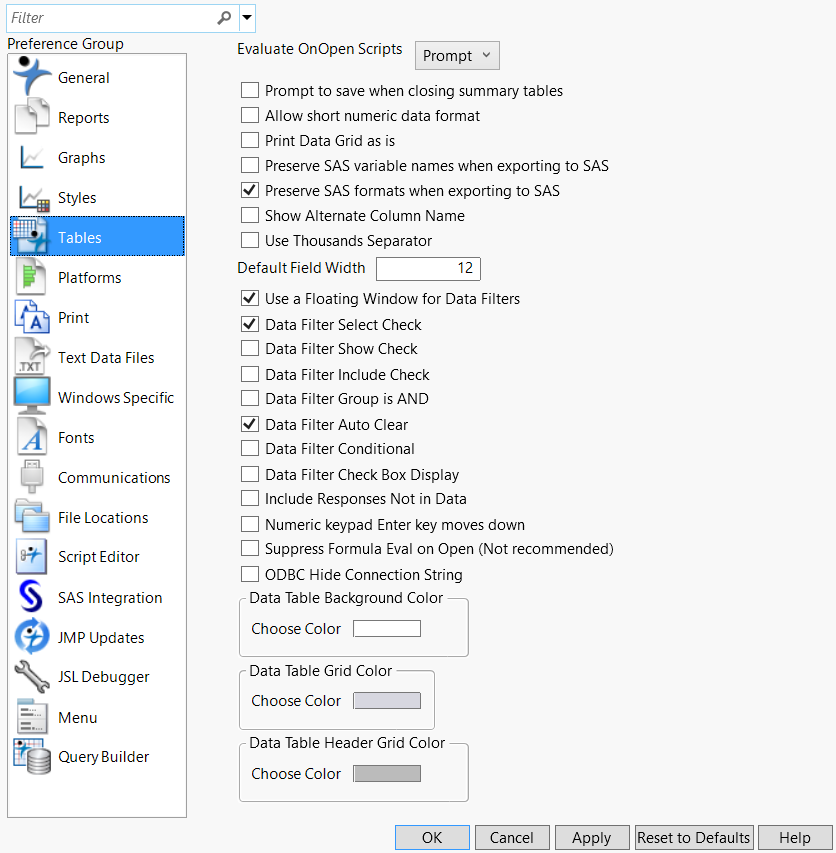

Figure 13.5 Tables Preferences
If you save a script to a data table and name it OnOpen or On Open, JMP can automatically run the script whenever you open the data table. On Open scripts that execute other programs are never run.
Select Always to allow On Open scripts to run without prompting.
Select Never to prevent On Open scripts from automatically running when a data table is opened.
JMP has the ability to store numeric data in as few as 8 bits (one byte). This option makes short-integer formats available to you when you select Cols > Column Info and assign a column a data type. When you use the correct short-integer format for your data, the numbers are not displayed differently, but the data table uses less disk space. See The Short-Integer Format in The Column Info Window.
Select this option to have the Open Database command hide the ODBC connection settings (that is, user ID and password). See Database Access in the Scripting Guide book for additional information.
