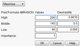

Figure 3.6 Response Goal Window

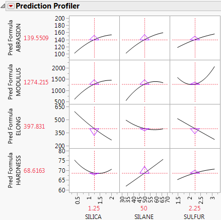

Shows or hides a purple triangle whose height and direction correspond to the value of the partial derivative of the profile function at its current value (see Figure 3.7). This is useful in large profiles to be able to quickly spot the sensitive cells.
Figure 3.7 Sensitivity Indicators
