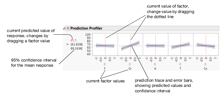

The Profiler (or Prediction Profiler) shows prediction traces for each X variable.
Figure 3.49 illustrates part of the profiler for the Reactor.jmp sample data table. The vertical dotted line for each X variable shows its current value or current setting. Use the Profiler to change one variable at a time in order to examine the effect on the predicted response.
Figure 3.49 Illustration of Prediction Traces
The factors F and Ct in Figure 3.49 are continuous. If the factor is nominal, the levels are displayed on the horizontal axis.
The horizontal dotted line shows the current predicted value of each Y variable for the current values of the X variables.
