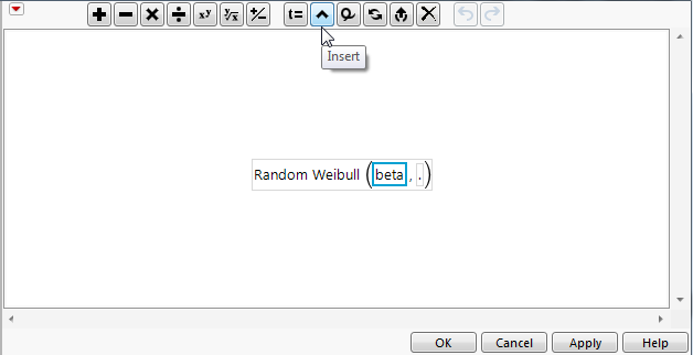

In the formula editor, select Random > Random Weibull.
6.
7.
Right-click in the Parameter Estimates report table and select Make into Data Table.
8.
Copy the entry in Row 2 in the Estimate column (1589.7167836).
9.
In the formula editor window, select the placeholder for beta in the Random Weibull formula and paste 1589.7167836 into the placeholder for beta.

In the data table that you created from the Parameter Estimates report, copy the entry in Row 1 in the Estimate column (99.918708989).
11.
In the formula editor window, select the placeholder for alpha in the Random Weibull formula and paste 99.918708989 into the placeholder for alpha.
Figure 11.29 Completed Formula Window

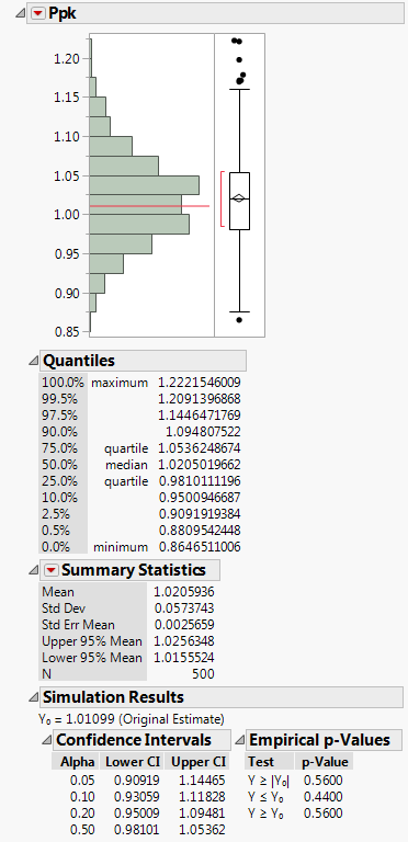

11.
Figure 11.30 Distribution of Simulated Ppk Values for Purity
Two Distribution reports are shown, one for Ppk and one for Ppl. But Purity has only a lower specification limit, so that the Ppk and Ppl values are identical. For this reason, the Distribution reports are identical.
The Simulation Results report shows that a 95% confidence interval for Ppk is 0.909 to 1.145. The true Ppk value could be above 1.0, which would place Purity above the Ppk = 1 line in the Capability Index Plot you constructed in Nonnormal Capability Analysis.

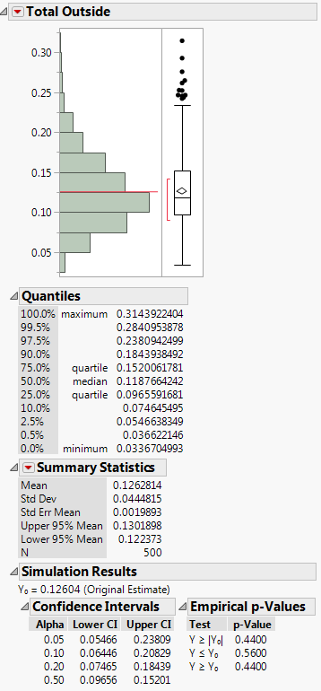

12.
In the Process Capability report, right-click the Expected Overall % column in the Nonconformance report and select Simulate.
In the Column to Switch Out list, make sure Purity is selected. In the Column to Switch In list, make sure Simulated Purity is selected.
13.
14.
15.
Click OK.
The calculation might take several seconds. A data table entitled Process Capability Simulate Results (Expected Overall %) appears. Because Purity has only a lower specification limit, the Below LSL values are identical to the Total Outside values.
