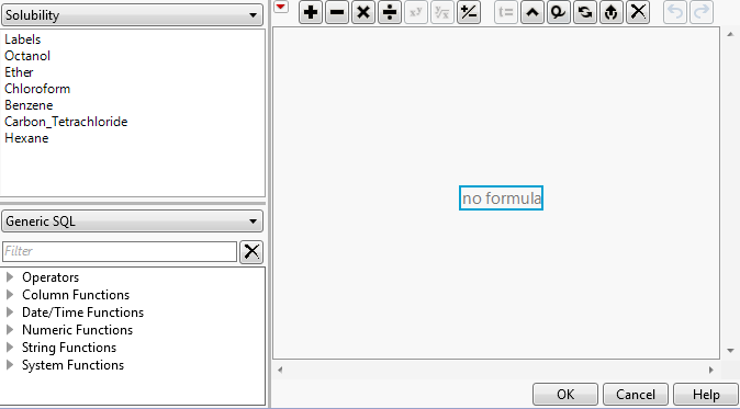

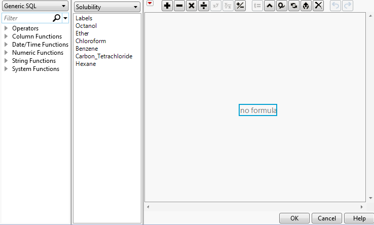

JMP provides help building WHERE clauses for SQL queries during ODBC import. It provides a WHERE clause editor that helps you build basic expressions using common SQL features, allowing vendor-specific functions. For example, you do not need to know whether SQL uses ‘=’ or ‘==’ for comparison, or avg() or average() for averaging.
In addition, string literals should be enclosed by single quotes (‘string’)rather than double quotes ("string").
Click the Where button.
The WHERE clause editor works similarly to the Formula Editor, which is described in the Formula Editor topic.
Figure 3.47 The WHERE Clause Editor
