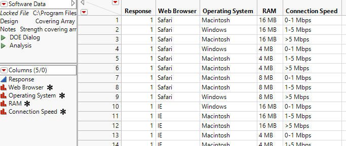

Figure 20.22 Partial View of Covering Array Table for Software Data.jmp Showing Scripts
Analysis Script
The Response column is continuous.
The Failure Analysis Details report contains a <k> Factor Interactions report. The value of k is the smallest number of interactions that detect a failure. (For a definition of detect, see Covering Arrays and Strength.) The three columns contain the following:
The Factors column lists all k-factor combinations that detect failures.
The Failure Levels column lists the values of the k factors in the Factors column that detect failures.
The Failure Count column gives the number of failures corresponding to the k-factor combination of Failure Levels.
Note: A failure observation can appear in more than one of the k-factor combinations listed in the Failure Levels column.
