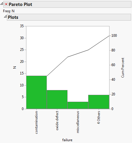

This example uses the Failure.jmp sample data table, which contains failure data and a frequency column. It lists causes of failure during the fabrication of integrated circuits and the number of times each type of defect occurred. A threshold value of 2 is specified for this example.
5.
7.
Click OK.
Figure 12.8 Pareto Plot with a Threshold Count of 2
Figure 12.8 displays the plot after specifying a count of 2. All causes with counts 2 or fewer are combined into the final bar labeled 4 Others.

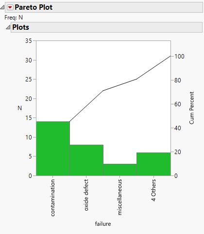

To separate the combined bars into original categories as shown in Figure 12.9, select Causes > Separate Causes.
Figure 12.9 Pareto Plot with Separated Causes
