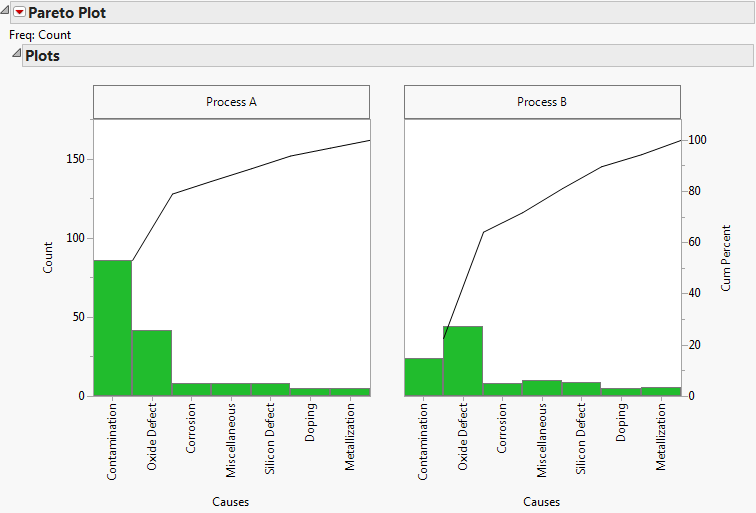

This example uses the Failures.jmp sample data table, which contains failure data and a frequency column. It lists causes of failure during the fabrication of integrated circuits and the number of times each type of defect occurred for two processes. A constant sample size of 1000 is specified for this example.

Click OK.
Figure 12.10 Pareto Plot Report Window

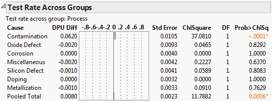

Figure 12.11 Test Rates across Groups Results
