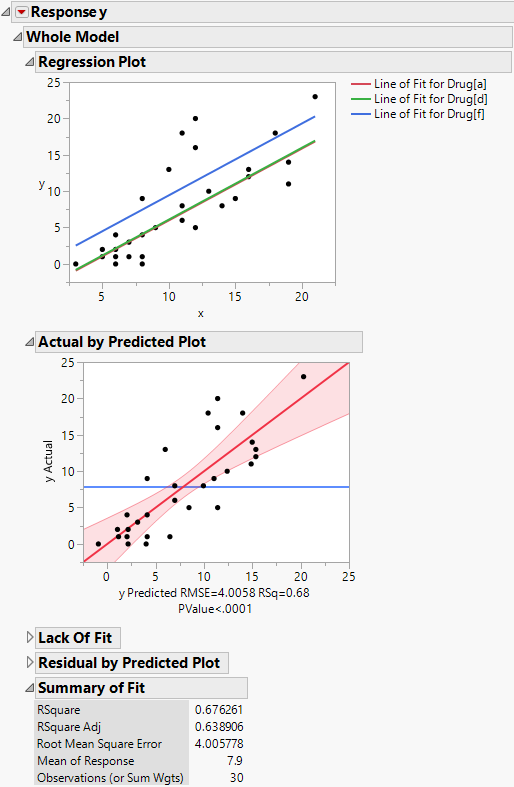

The Regression Plot in the report shows that you have fit a model with equal slopes (Figure 3.4). Compared to the main effects model (Drug effect only), RSquare increases from 22.8% to 67.6%. The Root Mean Square Error decreases from 6.07 to 4.0. As shown in Figure 3.4, the F-test significance probability for the whole model decreases from 0.03 to less than 0.0001.
Figure 3.4 Analysis of Covariance for Drug Data
The drug data table contains replicated observations. For example, rows 1 and 11 both have Drug = a and x = 11. In modeling fitting, replicated observations can be used to construct a pure error estimate of variation. Another estimate of error can be constructed for unspecified functional forms of covariates, or interactions of nominal effects. These estimates form the basis for a lack of fit test. If the lack of fit error is significant, this indicates that there is some effect in your data not explained by your model.
The covariate, x, accounts for much of the variation in the response previously accounted for by the Drug variable. Thus, even though the model is fit with much less error, the Drug effect is no longer significant. The significance of Drug observed in the main effects model appears to be explained by the covariate.

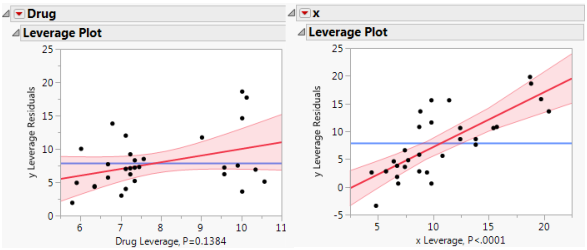

Figure 3.5 shows a leverage plot for each effect. Because the covariate is significant, the leverage values for Drug are dispersed somewhat from their least squares means.
