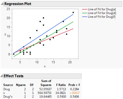

A portion of the report is shown in Figure 3.6. The Regression Plot shows fitted lines with different slopes. The Effect Tests report gives a p-value for the interaction of 0.56. This is not significant, indicating the model does not need to include different slopes.

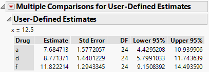

The User-Defined Estimates report shows least square means estimates for each level of Drug with the covariate x set to 12.5. The red triangle menu next to Multiple Comparisons for User-Defined Estimates contains options that enable you to test for differences among the estimates.

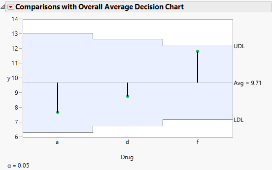

From the red triangle menu next to Multiple Comparisons for User-Defined Estimates, select Comparisons with Overall Average.
