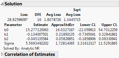

Select Analyze > Specialized Modeling > Nonlinear.
5.
Click OK.
6.
Click Go.
7.
Click Confidence Limits.
Figure 13.13 Solution Report
