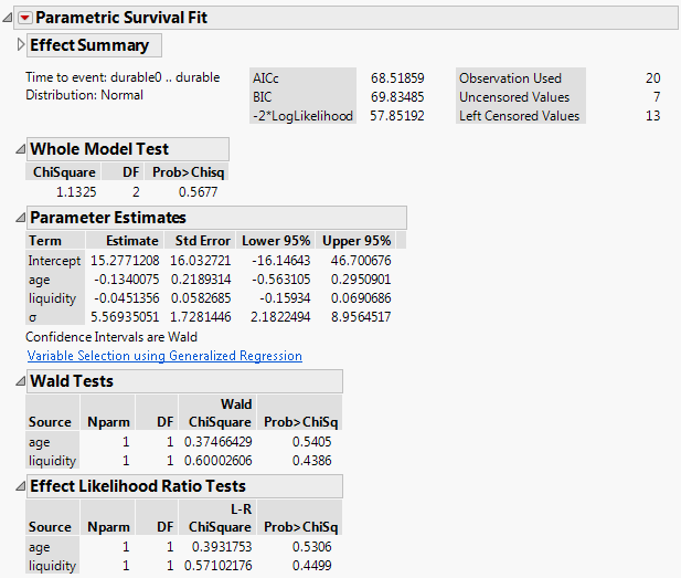

The Tobit model from the previous section assumes a normal distribution that is censored at zero. An observation of zero is considered to be left-censored. In the Fit Parametric Survival platform, left-censored observations are specified using two response columns. In this example, you create a new column that indicates observations for which left censoring has occurred. For left-censored observations, the new column contains a missing value. Otherwise, it contains the observed value of durable. The new column is then used as the left side of interval-censored observations, and the existing column durable is used as the right side of the intervals.

Select Analyze > Reliability and Survival > Fit Parametric Survival.
11.
12.
13.
14.
15.
Click Run.
Figure 13.15 Tobit Model Results
