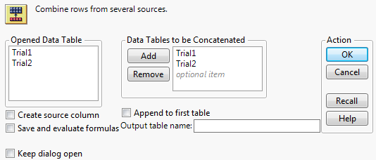

Figure 5.19 Concatenate Window
(Optional) Click the Save and evaluate formulas choice to request that JMP include all formulas.
(Optional) Click the Create source column choice to add a column called Source Table to the new data table.
5.
(Optional) Select the Append to first table choice to append rows to the data table listed first in the Data Tables to be Concatenated field. This option is an alternative to creating a new data table.
6.
(Optional) Enter a name for the new data table in the Output table name field.
If you do not enter a name, JMP names the data table Untitled# (for example, Untitled1). The Output table name field is not available if you selected the Append to first table choice.
7.
Click OK.
