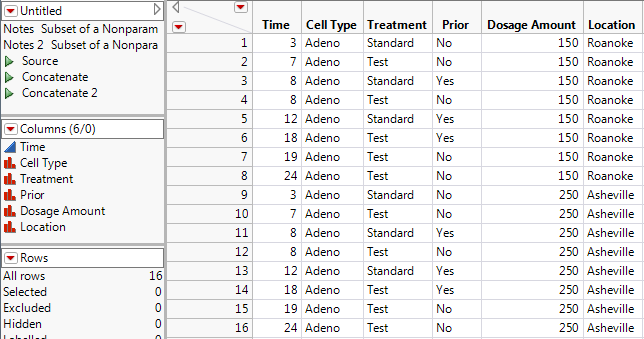

For example, suppose that two cancer trials were conducted at two different hospitals. One of the trials’ data is in the Cancer1.jmp data table, and the other trial’s data is in the Cancer2.jmp data table.
1.
Select Help > Sample Data Library and open Cancer1.jmp andCancer2.jmp.
Notice that there are two distinct table variables: Dosage Amount and Location. In the concatenated table, columns are created for these two table variables.
2.
From the Cancer1.jmp data table, select Tables > Concatenate.
3.
Select Cancer2 and click Add.
4.
Figure 5.21 Data and Variables Concatenated
