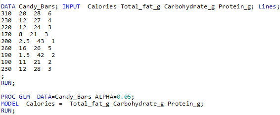

This example uses the Candy Bars.jmp sample data table, which contains nutrition data for candy bars.
5.
From the red triangle menu for Model Specification, select Create SAS Job.
Figure 6.156 shows the SAS code. (Not all of the data is shown.)
Figure 6.156 SAS Code
