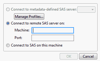

From the red triangle menu for Model Specification, select Submit to SAS.
6.
In the Connect to SAS Server window (see Figure 6.157), choose a method to connect to SAS (if you are not already connected). For this example, select Connect to SAS on this machine.
Figure 6.157 Connect to SAS Server
7.
Click OK.

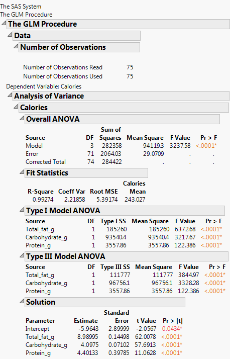

JMP connects to SAS. SAS runs the model and sends the results back to JMP. The results can appear as SAS output, HTML, RTF, PDF, or JMP report format (you can choose the format using JMP Preferences). Figure 6.158 shows the results formatted as a JMP report. For details, see Import Data from SAS in the Using JMP book.
Figure 6.158 SAS Results Formatted as a JMP Report
