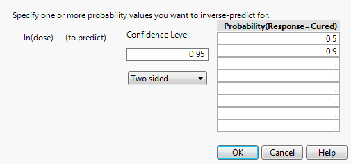

Type 0.95 for the Confidence Level.
8.
Select Two sided for the confidence interval.
9.
Request the response probability of interest. Type 0.5 and 0.9 for this example, which indicates you are requesting the values for ln (dose) that correspond to a 0.5 and 0.9 probability of being cured.
10.
Click OK.

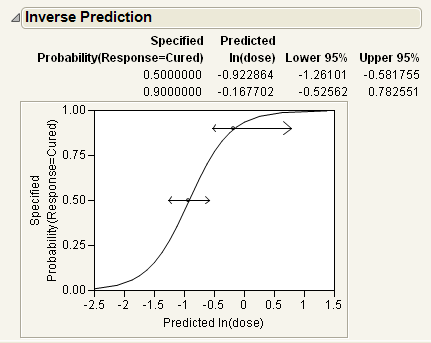

Figure 7.124 Inverse Prediction Window
Figure 7.125 Example of Inverse Prediction Plot
The estimates of the x values and the confidence intervals are shown in the report as well as in the probability plot. For example, the value of ln (dose) that results in a 90% probability of being cured is estimated to be between -0.526 and 0.783.
