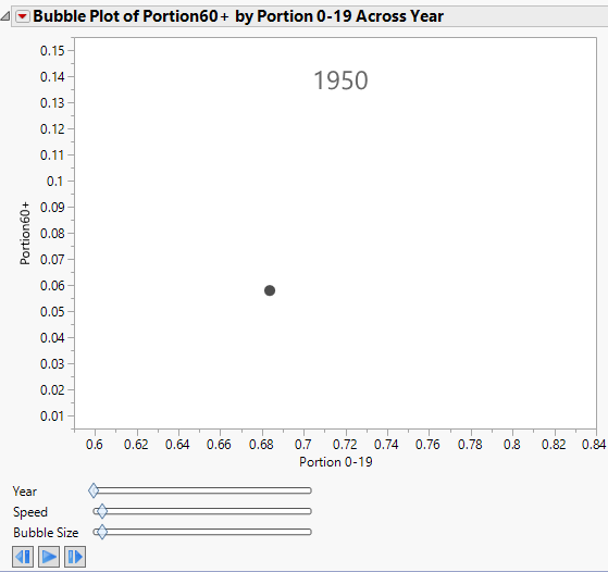

For dynamic bubble plots, you might specify only a Time variable and no ID variable. The resulting bubble plot contains a single moving bubble that tracks the series as the Time value changes.
1.
Select Help > Sample Data Library and open PopAgeGroup.jmp.
2.
Select Graph > Bubble Plot.
3.
Select Portion60+ and click Y.
4.
Select Portion 0-19 and click X.
5.
Select Year and click Time.
6.

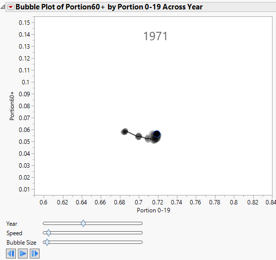

Figure 7.7 The Initial Report Window with a Time Variable
8.
From the red triangle menu, select Trail Bubbles > All and Trail Lines > All.
Figure 7.8 Animated Bubble Plot over Time
