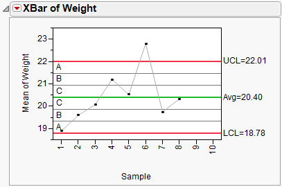

Shows or hides the zone lines. The zones are labeled A, B, and C as shown here in the Mean plot for weight in the Coating.jmp sample data. Control Chart tests use the zone lines as boundaries. The seven zone lines are set one sigma apart, centered on the center line.
Figure 3.13 Show Zones

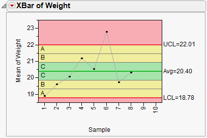

Figure 3.14 Shade Zones
