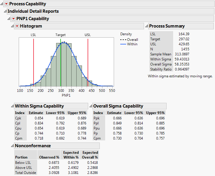

Figure 10.14 shows the Individual Detail Report for PNP1 from the Semiconductor Capability.jmp sample data table as described in Example of the Process Capability Platform with Normal Variables.
Figure 10.14 Individual Detail Report
The Individual Details report for a variable with a normal distribution shows a histogram, process summary details, and capability and nonconformance statistics. The histogram shows the distribution of the values, the lower and upper specification limits and the process target (if they are specified), and one or two curves showing the assumed distribution. The histogram in Figure 10.14 shows two normal curves, one based on the overall estimate of standard deviation and the other based on the within-subgroup estimate.
When you fit your process with a normal distribution, the Process Summary includes the Stability Ratio, which is a measure of stability of the process. The stability ratio is defined as follows:

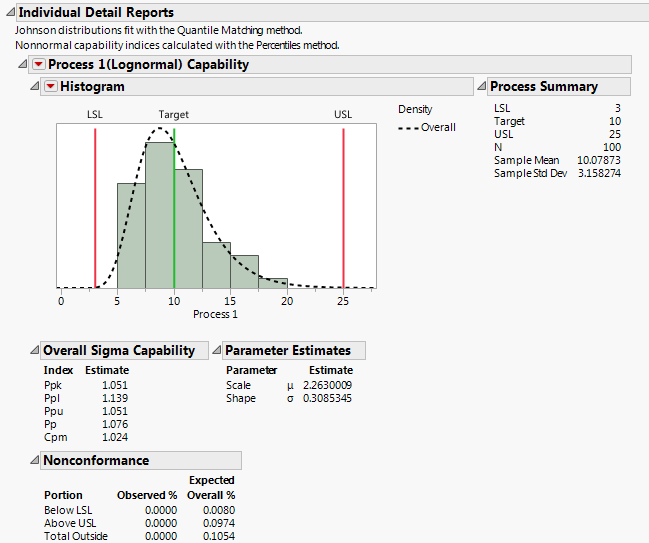

Figure 10.15 shows the Individual Detail Report for Process 1 from the Process Measurements.jmp sample data table as described in Example of the Process Capability Platform with Nonnormal Variables.
Figure 10.15 Individual Detail Report for Process 1
The report also shows a Parameter Estimates report if you selected a nonnormal parametric distribution or a Nonparametric Density report if you selected a Nonparametric fit. See Parameter Estimates and Nonparametric Density.

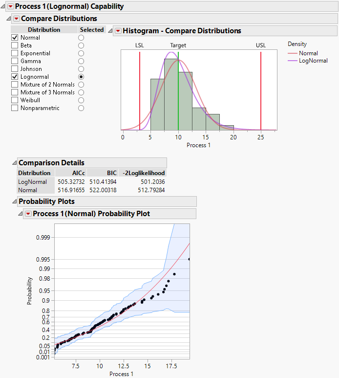

Figure 10.16 shows the Compare Distributions report for Process 1 in the Process Measurements.jmp sample data table. The Selected distribution, which is Lognormal, is being compared to a Normal distribution. The Comparison Details report shows fit statistics for both distributions.
You can obtain probability plots by selecting the Probability Plots option from the Compare Distributions red triangle menu. The points in the probability plot for the normal distribution in Figure 10.16 do not follow the line closely. This indicates a poor fit.
For each distribution, gives AICc, BIC, and -2Loglikelihood values. See Likelihood, AICc, and BIC in the Fitting Linear Models book. (Not available for a Nonparametric fit.)
Shows or hides a report that displays probability plots for each parametric distribution that you fit. See Figure 10.16. An observation’s horizontal coordinate is its observed data value. An observation’s vertical coordinate is the value of the quantile of the fitted distribution for the observation’s rank. For the normal distribution, the overall estimate of sigma is used in determining the fitted distribution.
