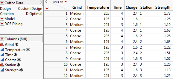

Your design and the experimental results for Strength are given in the Coffee Data.jmp sample data table (Figure 2.11), located in the Design Experiment folder.
Figure 2.11 Coffee Design with Strength Results
