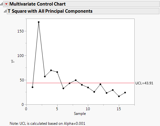

Select Analyze > Quality and Process > Control Chart > Multivariate Control Chart.
Select all of the columns and click Y, Columns.
Click Get Targets.
5.
Open the Steam Turbine Targets.jmp table that you saved.
6.
Click OK.
7.
From the red triangle menu, select Set Alpha Level > Other.
8.
Figure 6.4 Steam Turbine Control Chart
Figure 6.4 shows out-of-control conditions occurring at observations 2, 3, 4, 5, and 8. This result implies that these observations do not conform to the historical data from Steam Turbine Historical.jmp, and that the process should be further investigated. To find an assignable cause, you might want to examine individual univariate control charts or perform another univariate procedure.
