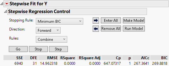

Figure 4.3 Stepwise Regression Control Panel
The Stopping Rule determines which model is selected. For all stopping rules other than P-value Threshold, only the Forward and Backward directions are allowed. The only stopping rules that use validation are Max Validation RSquare and Max K-Fold RSquare. See Using Validation.
Prob to Enter is the maximum p-value that an effect must have to be entered into the model during a forward step.
Prob to Leave is the minimum p-value that an effect must have to be removed from the model during a backward step.

Notice that the default selection for Direction is Forward.

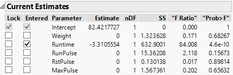

Click Step.
In Figure 4.4, you can see that after one step, the most significant term, Runtime, is entered into the model.

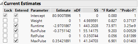

Click Go.

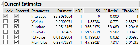

Click Enter All.
Figure 4.6 All Effects Entered Into the Model

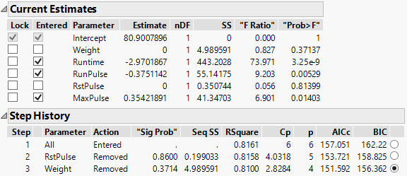

For Direction, select Backward.
Click Step two times.
The Current Estimates and Step History tables shown in Figure 4.7 summarize the backward stepwise selection process. Note the BIC value of 156.362 for the third step in the Step History table. If you click Step again to remove another parameter from the model, the BIC value increases to 159.984. For this reason, you choose the step 3 model. This is also the model that the Go button produces.
