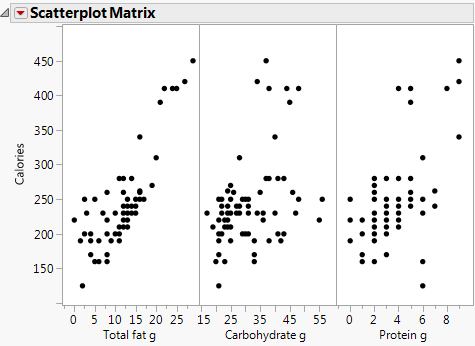

Use multiple regression to predict the average response variable using these three predictor variables.
5.
Click OK.
Figure 3.103 Scatterplot Matrix Results

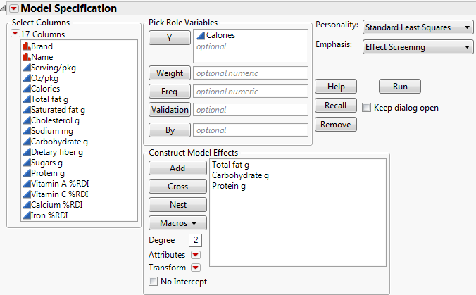

Continue to use the Candy Bars.jmp sample data table.
Next to Emphasis, select Effect Screening.
Figure 3.104 Fit Model Window
5.
Click Run.

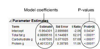

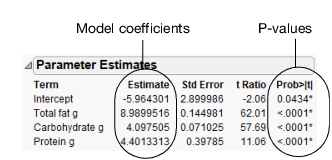

Figure 3.106 Parameter Estimates Report

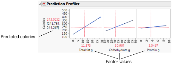

Use the Prediction Profiler to see how changes in the factors affect the predicted values. The profile lines show the magnitude of change in calories as the factor changes. The line for Total fat g is the steepest, meaning that changes in total fat have the largest effect on calories.
Figure 3.107 Prediction Profiler

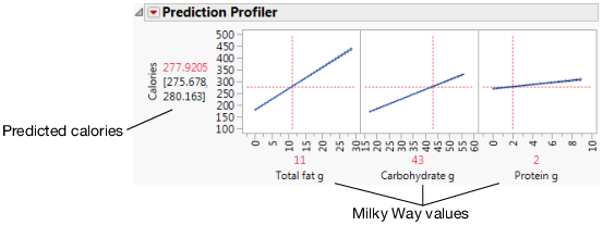

Figure 3.108 Factor Values for the Milky Way
