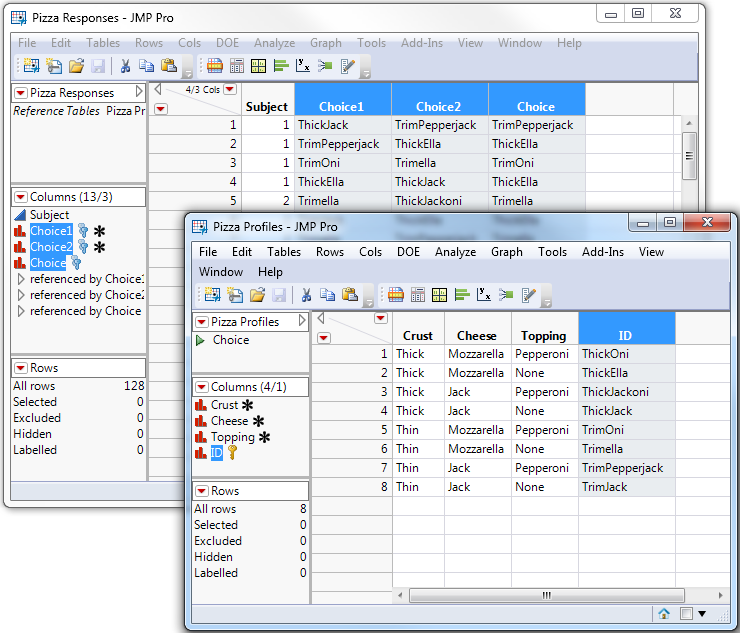

The Link Reference column property links a column in the main data table to the Link ID column in the referenced data table. The column property specifies the path name of the referenced data table. The column that has a link reference is referred to as the referencing column. The referencing column can look up the data of the auxiliary data tables through the Link ID column.
Figure 5.36 shows an example of virtually joined data tables. Pizza Profiles.jmp is the referenced data table because the ID column contains a Link ID column property. The ID column contains unique values that correspond to data in the referencing data table, Pizza Responses.jmp.
Figure 5.36 Virtually Joined Data Tables
