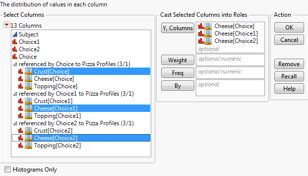

In Pizza Responses.jmp, select Analyze > Distribution.
Figure 5.37 Distribution Launch Window

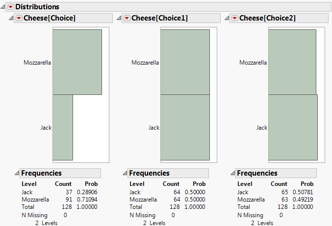

More respondents chose Mozzarella in the Choice column. In Choice1 and Choice2, the proportion of Mozzarella to Jack is nearly even.
Figure 5.38 Distribution of Pizza Responses
