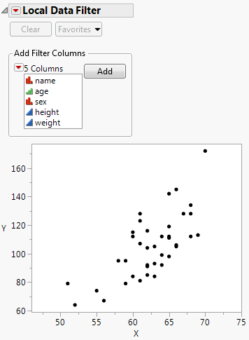

The following example creates a local data filter for a Graph Box. See Figure 9.9 for the output.
New Window( "Marker Seg Example",
	Data Filter Context Box(
		V List Box(
			dt << Data Filter( Local ),
			g = Graph Box(
				Frame Size( 300, 240 ),
				X Scale( Min( xx ) - 5, Max( xx ) + 5 ),
				Y Scale( Min( yy ) - 5, Max( yy ) + 5 ),
				Marker Seg( xx, yy, Row States( dt, rows ) )
Tip: The preceding script is part of a larger script that first builds the arrays required for a marker seg. To experiment with this script, open the Local Data Filter for Custom Graph.jsl sample script.
Figure 9.9 Local Data Filter and Graph

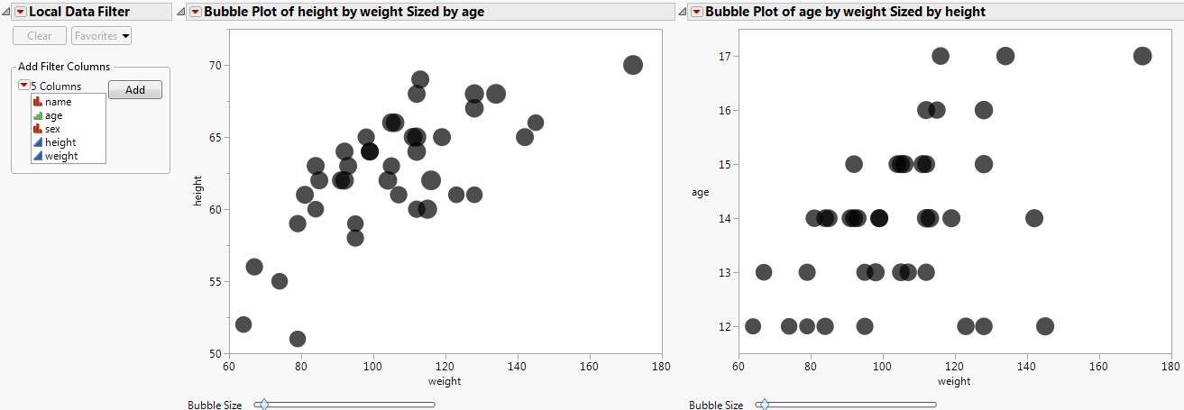

A context box can also contain several graphs with one local filter. The filtering then applies to both graphs. The following script creates two bubble plots and one data filter in one context box. See Figure 9.10 for the output.
New Window( "Shared Local Filter",
		H List Box(
			Platform(
				dt,
				Bubble Plot( X( :weight ), Y( :height ), Sizes( :age ) )
			Platform(
				dt,
				Bubble Plot( X( :weight ), Y( :age ), Sizes( :height ) )
Tip: To experiment with this script, open the Local Data Filter Shared.jsl sample script.
Figure 9.10 Local Filter with Two Bubble Plots

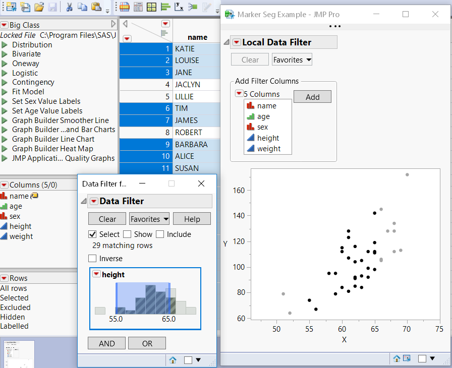

		V List Box(
			g = Graph Box(
Heights greater than or equal to 55 and less than or equal to 65 are initially filtered. Then the user can work with the local data filter to filter columns on the graph.
