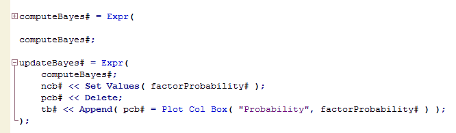

Figure 4.7 Code Folding Markers Shown in a Script
By default, code does not remain collapsed after you save the script and restart JMP. To save the state of the folded code, select Save and restore document state information in the Script Editor preferences.
