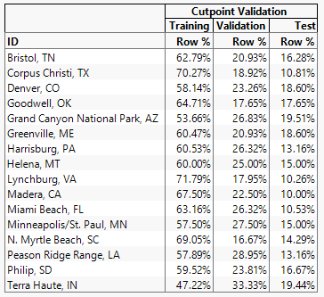

9. Select Analyze > Tabulate.
10. Click ID and drag it to the Drop zone for rows.
11. Click Cutpoint Validation and drag it on top of N.
12. Click Row% and drag it on top of the cells.
Figure 11.4 Cutpoint Validation Column Proportions
Figure 11.4 shows that not all of the weather stations have the correct proportions for the training, validation, and test sets. Use a Batch ID column to obtain the correct percentages.

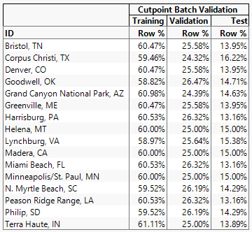

11. Click Cutpoint Batch Validation and drag it on top of N.
Figure 11.5 Cutpoint Validation Column with Batch ID Proportions
Figure 11.5 shows that using a Cutpoint Batch ID column ensures that each weather station has proportions for the training, validation, and test sets that are much closer to the specified values.
