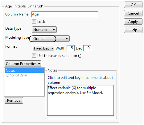

1. Double-click the Age column heading. The Column Info window appears.
2. Change the Modeling Type to Continuous.
Figure 5.5 Column Info Window
3. Click OK.

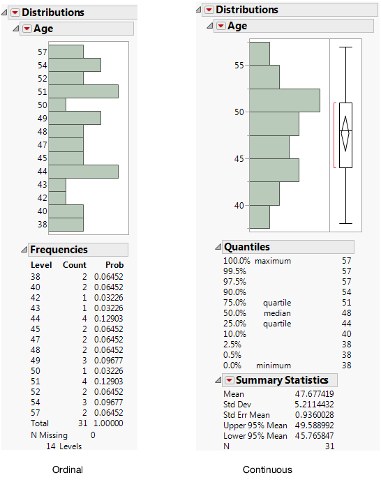

4. Repeat the steps in the example (see Example of Viewing Modeling Type Results) to create the distribution. Figure 5.6 shows the distribution results when Age is ordinal and continuous.
Figure 5.6 Different Modeling Types for Age
When age is ordinal, you can see the frequency counts for each age. For example, age 48 appears two times. When age is continuous, you can find the mean age, which is nearly 48 (47.677)
