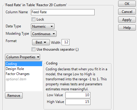

When any DOE platform other than Accelerated Life Test Design creates a design, JMP defines a Coding column property for each non-mixture factor with a numeric data type. Figure A.12 shows the Coding column property panel for the column Feed Rate in the Reactor 20 Custom.jmp sample data table, found in the Design Experiment folder.
Figure A.12 Coding Property Panel for Feed Rate
